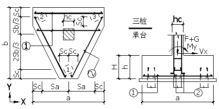

柱网布置详见附图

  本工程中承台混凝土等级C30,取其中的(8)-(A)柱位置的承台为例计算:
一、基本资料:
承台类型:三桩承台 圆桩直径 d = 500mm
桩列间距 Sa = 900mm 桩行间距 Sb = 1560mm
桩中心至承台边缘距离 Sc = 500mm
承台根部高度 H = 1100mm 承台端部高度 h = 1100mm
柱子高度 hc = 700mm(X 方向) 柱子宽度 bc = 650mm(Y 方向)

四、承台验算:
圆桩换算桩截面边宽 bp = 0.866d = 0.866*500 = 433mm
 1、承台受弯计算:
 (1)单桩桩顶竖向力计算:
在轴心竖向力作用下
Qk = (Fk + Gk) / n (基础规范 8.5.3-1)
Qk = (4666+235)/3 = 1633.7kN ≤ Ra = 2020kN
每根单桩所分配的承台自重和承台上土自重标准值 Qgk:
Qgk = Gk / n = 235/3 = 78.3kN
扣除承台和其上填土自重后的各桩桩顶相应于荷载效应基本组合时的竖向力设计值:
Ni = γz * (Qik - Qgk)
N = 1.35*(1633.7-78.3) = 2099.7kN
(2)承台形心到承台两腰的距离范围内板带的弯矩设计值:
S = (Sa ^ 2 + Sb ^ 2) ^ 0.5 = (0.9^2+1.56^2)^0.5 = 1.801m
αs = 2Sa = 2*0.9 = 1.800m
α = αs / S = 1.8/1.801 = 0.999
承台形心到承台两腰的距离 B1:
B1 = Sa / S * 2Sb / 3 + Sc * (Sa + Sb) / S = 1.203m
M1 = Nmax * [S - 0.75 * c1 / (4 - α ^ 2) ^ 0.5] / 3 (基础规范 8.5.16-4)
= 2099.7*[1.801-0.75*0.65/(4-0.999^2)^0.5]/3
= 1063.6kN·m
②号筋 Asy = 3783mm? ζ = 0.068 ρ = 0.32%
10Φ22@110 (As = 3801)
(3)承台形心到承台底边的距离范围内板带的弯矩设计值:
承台形心到承台底边的距离 B2 = Sb / 3 + Sc = 1.020m
M2 = Nmax * [αs - 0.75 * c2 / (4 - α ^ 2) ^ 0.5] / 3 (基础规范 8.5.16-5)
= 2099.7*[1.8-0.75*0.7/(4-0.999^2)^0.5]/3
= 1047.7kN·m
①号筋 Asx = 3667mm? ζ = 0.076 ρ = 0.36%
10Φ22@100 (As = 3801)

a11 = Sa - 0.5bp - 0.5bc = 900-433/2-650/2 = 333mm
λ11 = a11 / ho = 333/(1100-110) = 0.337
底部角桩冲切系数 β11 = 0.56 / (λ11 + 0.2) (基础规范 8.5.17-9)
β11 = 0.56/(0.337+0.2) = 1.043
β11 * (2c1 + a11) * tg(θ1 / 2) * βhp * ft * ho
= 1.043*(2*1293+333)*tg30°*0.975*1.43*990
= 2433399N ≥ Nl = 2099700N,满足要求。
3、承台斜截面受剪承载力计算:
(1)X方向(上边)斜截面受剪承载力计算:
扣除承台及其上填土自重后 X 方向斜截面的最大剪力设计值:
Vx = N2 + N3 = 4199400N
柱上边缘计算宽度 bxo:
Sb / 3 - Sc = 1560/3-500 = 20mm ≤ 0.5bc = 325mm
bxo = a = 2800mm
承台斜截面受剪承载力按下列公式计算:
Vx ≤ βhs * βy * ft * bxo * ho (基础规范 8.5.18-1)
X 方向上自桩内边缘到最近柱边的水平距离:
ay = 520 - 0.5bc - 0.5bp = 520-650/2-433/2 = -22mm
λy = ay / ho = -22/(1100-110) = -0.022
当 λy < 0.3 时,取 λy = 0.3
βy = 1.75 / (λy + 1.0) = 1.75/(0.3+1.0) = 1.346
βhs * βy * ft * bxo * ho = 0.95*1.346*1.43*2800*990 = 5069495N
≥ Vx = 4199400N,满足要求。
(2)X方向(下边)斜截面受剪承载力计算:
Vx = N1 = 2099700N
柱下边缘计算宽度 bxo:
bxo = 2 * [Sc + (2Sb / 3 - 0.5bc + Sc) * Sa / Sb] = 2402mm
承台斜截面受剪承载力按下列公式计算:
ay = 1040 - 0.5bc - 0.5bp = 1040-650/2-433/2 = 498mm
λy = ay / ho = 498/(1100-110) = 0.504
βy = 1.75 / (λy + 1.0) = 1.75/(0.504+1.0) = 1.164
βhs * βy * ft * bxo * ho = 0.95*1.164*1.43*2402*990 = 3760082N
≥ Vx = 2099700N,满足要求。
(3)Y方向斜截面受剪承载力计算:
扣除承台及其上填土自重后 Y 方向斜截面的最大剪力设计值:
Vy = Max{N2 , N3} = 2099700N
承台斜截面受剪承载力按下列公式计算:
Vy ≤ βhs * βx * ft * byo * ho (基础规范 8.5.18-1)
Y 方向上自桩内边缘到最近柱边的水平距离:
ax = 900 - 0.5hc - 0.5bp = 900-700/2-433/2 = 333mm
λx = ax / ho = 333/(1100-110) = 0.337
βx = 1.75 / (λx + 1.0) = 1.75/(0.337+1.0) = 1.309
βhs * βx * ft * byo * ho = 0.95*1.309*1.43*2560*990 = 4507164N
≥ Vy = 2099700N,满足要求。
4、柱下局部受压承载力计算:
局部荷载设计值 F = 6299100N
混凝土局部受压面积 Al = bc * hc = 455000mm?
承台在柱下局部受压时的计算底面积按下列公式计算:
Ab = (bx + 2 * c) * (by + 2 * c)
c = Min{Cx, Cy, bx, by} = Min{1050,955,700,650} = 650mm
Ab = (700+2*650)*(650+2*650) = 3900000mm?
βl = Sqr(Ab / Al) = Sqr(3900000/455000) = 2.928
ω * βl * fcc * Al = 1.0*2.928*0.85*14.33*455000 = 16227305N
≥ F = 6299100N,满足要求。
5、桩局部受压承载力计算:
局部荷载设计值 F = Nmax + γg * Qgk = 2099.7+1.35*78.3 = 2205.4kN
混凝土局部受压面积 Al = π * d ^ 2 / 4 = 196350mm?
承台在角桩局部受压时的计算底面积按下列公式计算:
圆桩 bx = by = Sqr(Al) = 443mm
c = Min{Cx, Cy, bx, by} = Min{250,250,443,443} = 250mm
Ab = (443+2*250)*(443+2*250) = 889463mm?
βl = Sqr(Ab / Al) = Sqr(889463/196350) = 2.128
ω * βl * fcc * Al = 1.0*2.128*0.85*14.33*196350 = 5090815N
≥ F = 2205432N,满足要求。
