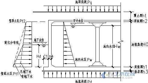

水池地基的荷载主要来自于:钢筋混凝土的自重、土的压力(地埋式)、水的重力。(抗浮的将另行开贴讨论)

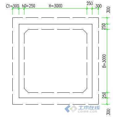

下以一小型水池作为例子,水池内空长度H=3000mm,水池内空宽度B=3000mm,池面板活荷载取P=1.5(KN/㎡),池内空高度h0=2000mm,钢筋混凝土密度25KN/m3,素混凝土23KN/m3,覆土密度18KN/m3

池顶活荷P1=1.5(KN/m^2) 覆土厚度ht=500(mm) 池内水位Hw=1500(mm) 容许承载力R=50(KN/m^2)
水池长度H=3000(mm) 水池宽度B=3000(mm) 池壁高度h0=2000(mm) 底板外伸C1=300(mm)
底板厚度h1=300(mm) 顶板厚度h2=120(mm) 垫层厚度h3= 100 (mm) 池壁厚度h4=250(mm)
地基承载力设计值R=50(KPa)

一.地基承载力验算
( 1 )底板面积AR1 = (H + 2 * h4 + 2 * C1) * (B + 2 * h4 + 2 * C1)
= ( 3 + 2 * .25 + 2 * .3 ) * ( 3 + 2 * .25 + 2 * .3 )
=16.81(m^2)
( 2 )顶板面积AR2 = (H + 2 * h4) * (B + 2 * h4)
= ( 3 + 2 * .25 ) * ( 3 + 2 * .25 )
=12.25(m^2)
( 3 )池顶荷载Pg = P1 + ht * 18
= 1.5 + .5 * 18
=10.5 (KN/m^2)
( 4 )池壁重量CB = 25 * (H + 2 * h4 + B) * 2 * H0 * h4
= 25 * ( 3 + 2 * .25 + 3 )* 2 * 2 * .25
=162.5(KN)
( 5 )底板重量DB1 = 25 * AR1 * h1
= 25 * 16.81 * .3
=126.0(KN)
( 6 )顶板重量DB2 = 25 * AR2 * h2
= 25 *12.25 * .12
=36.75(KN)
( 7 )水池全重G = CB + DB1 + DB2 + Fk1
=162.5+126.0+36.75 +0
=325.25(KN)
( 8 )单位面积水重Pwg = (H * B * Hw * 10) / AR1
= ( 3 * 3 * 1.5 * 10) / 16.81
=8.03(KN/m^2)(此外若上从更安全的角度考虑,最好取内空2.0作为计算值)
( 9 )单位面积垫层重Pd = 23 * h3
= 23 * .1
=2.3(KN/m^2)
( 10 )地基反力R0 = Pg + G / AR1 + Pwg + Pd
=10.5 + 325.25 / 16.81 + 8.03 + 2.3
= 40.17 (KN/m^2)
R0 = 40.17 (KN/m^2) < R = 50(KN /m^2) 地基承载力满足要求!
